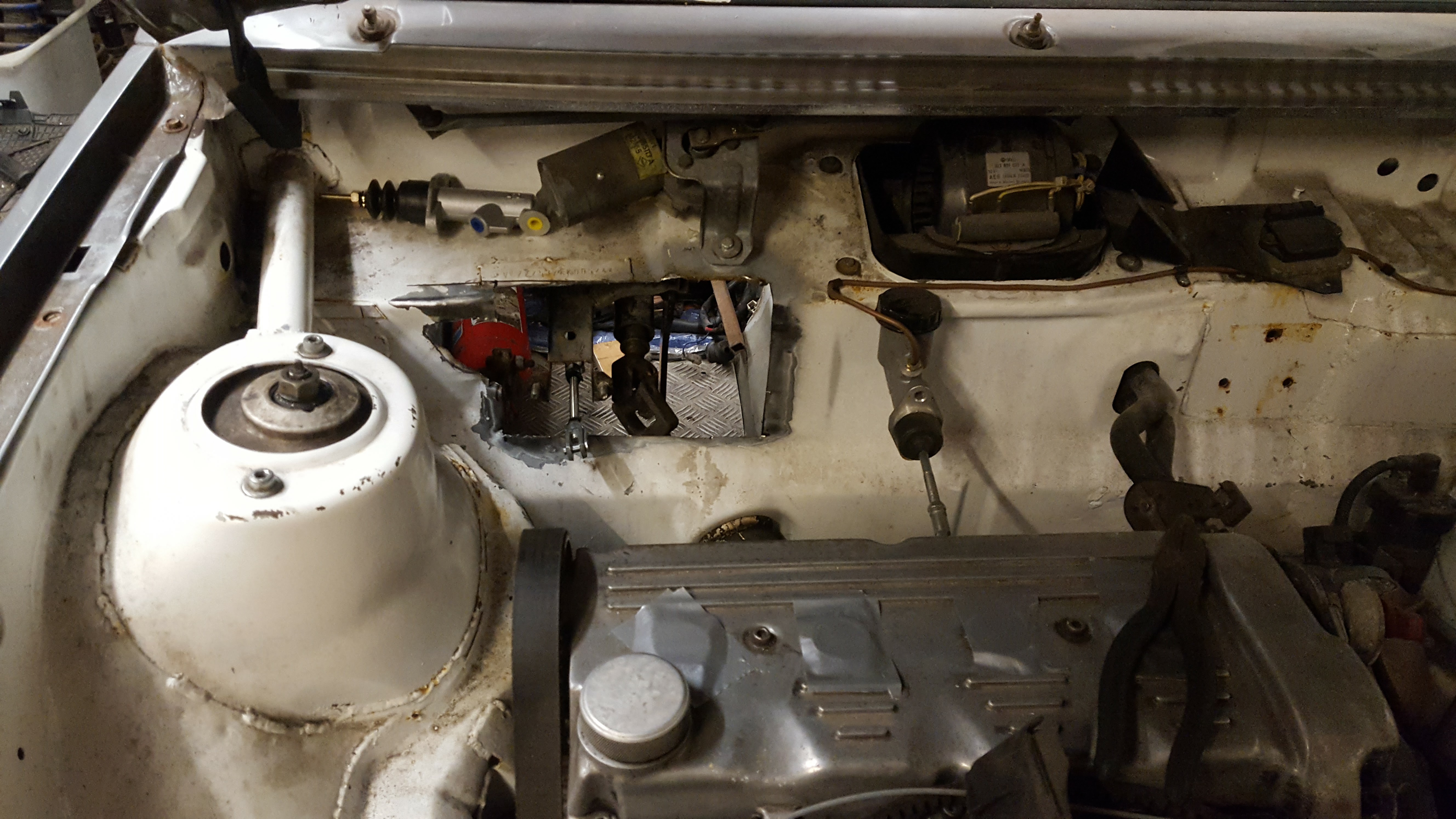

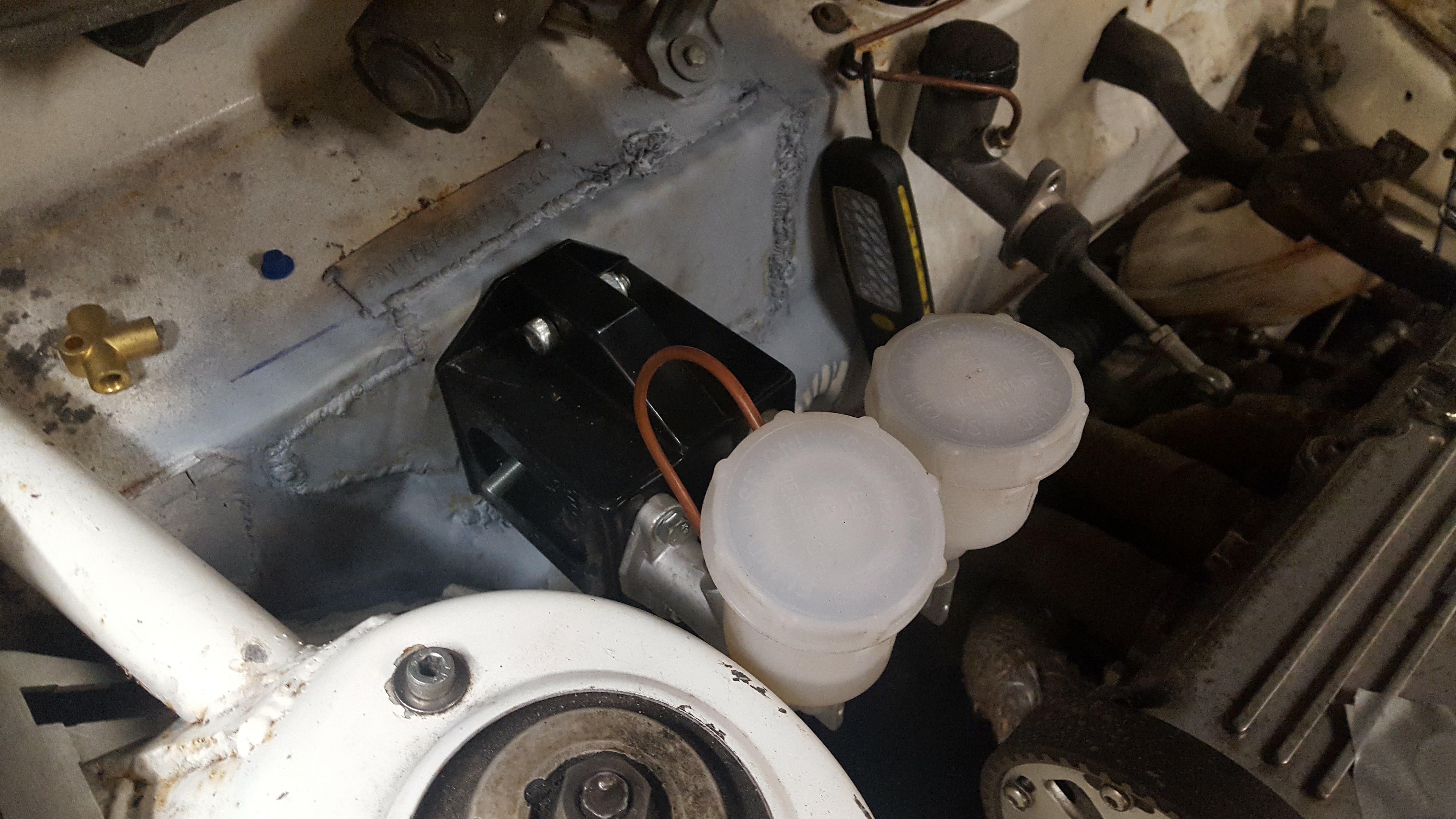

I've had so little time to do much by the looks of it. I have managed to do some little bits though. I've started looking at doing the hydraulic clutch conversion on the standard cable clutch gearbox. It's been a bit fiddly as the master cylinder wants to foul part of the roll cage. Once I've got that sorted I can get on with a big brake improvement...
It means I can get rid of all the cross bulkhead linkage and servo :) It frees up a load of space under the bonnet. I need to get some more welding done though, no major problems.
Talking of welding, I'm removing the boot floor to recess in the alloy race fuel tank. I'm toying with various ideas, so will update later.

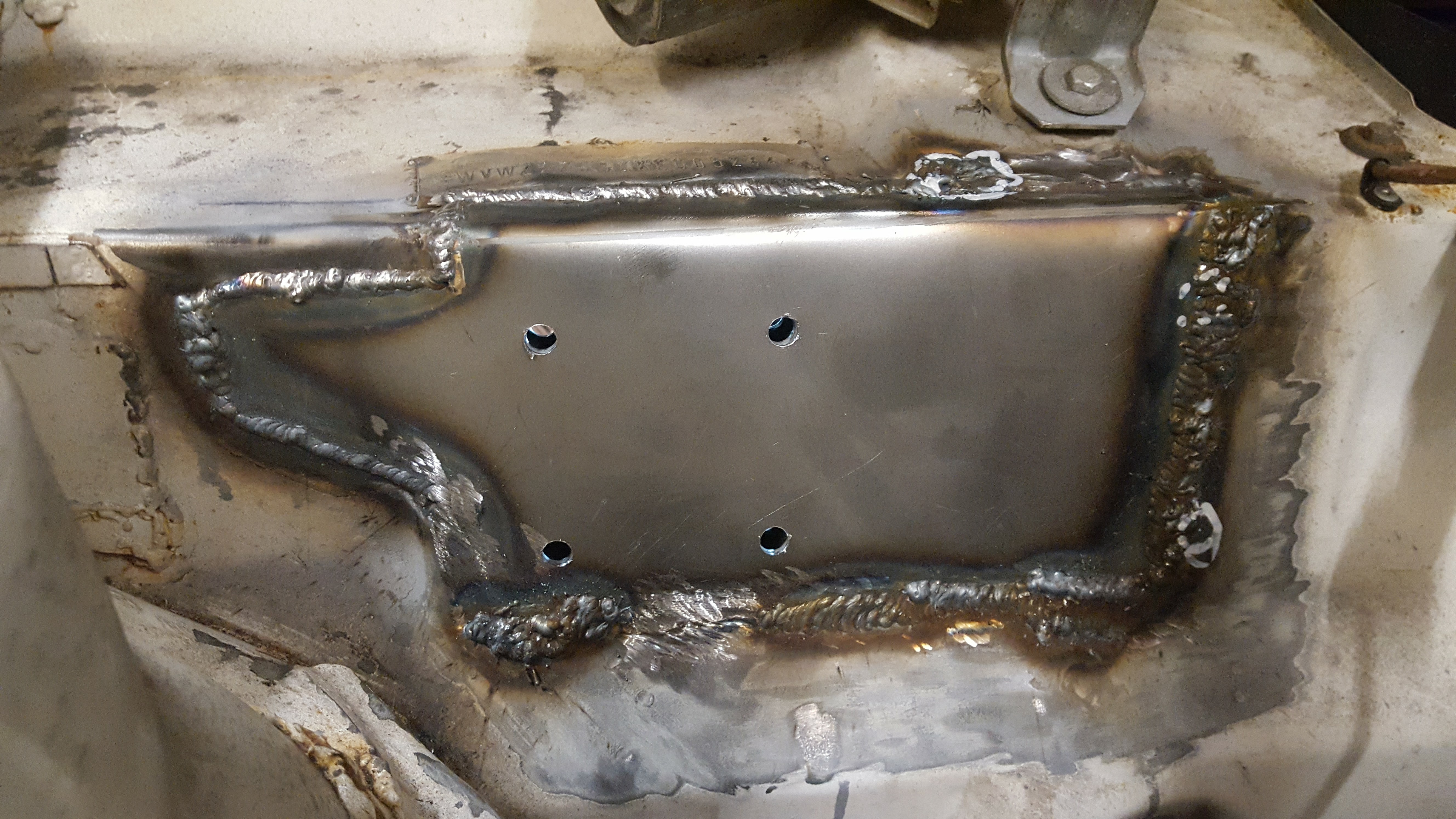

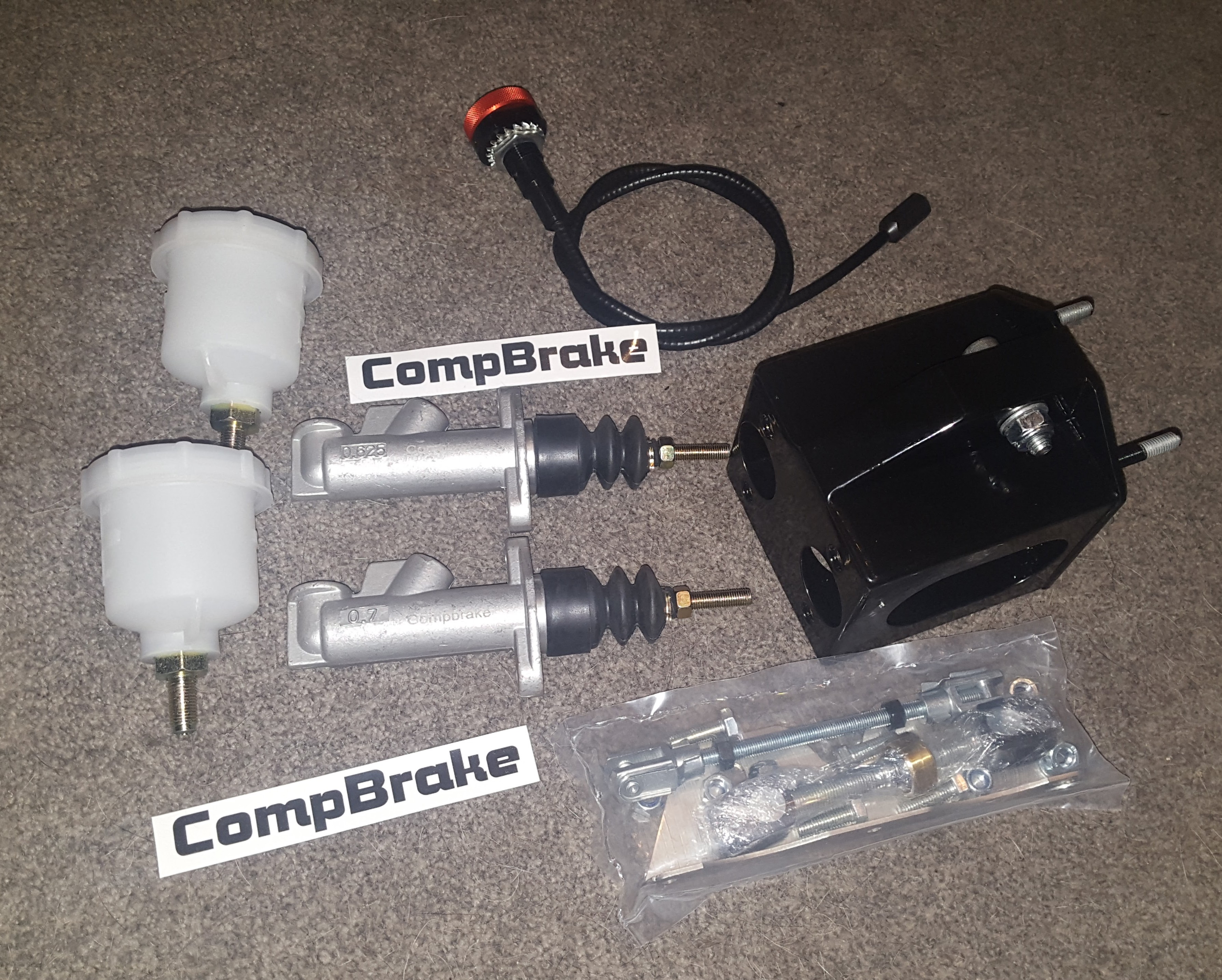

So, one year ago, I had some time free. I did, in fact, make a start on the brake bias pedal box. It was some time after doing this -
that I realised that this kit is designed to fit on the original mounting point of the brake servo :oops: Ah well, I was thinking about moving it all in front of the driver's seat anyway :lol:

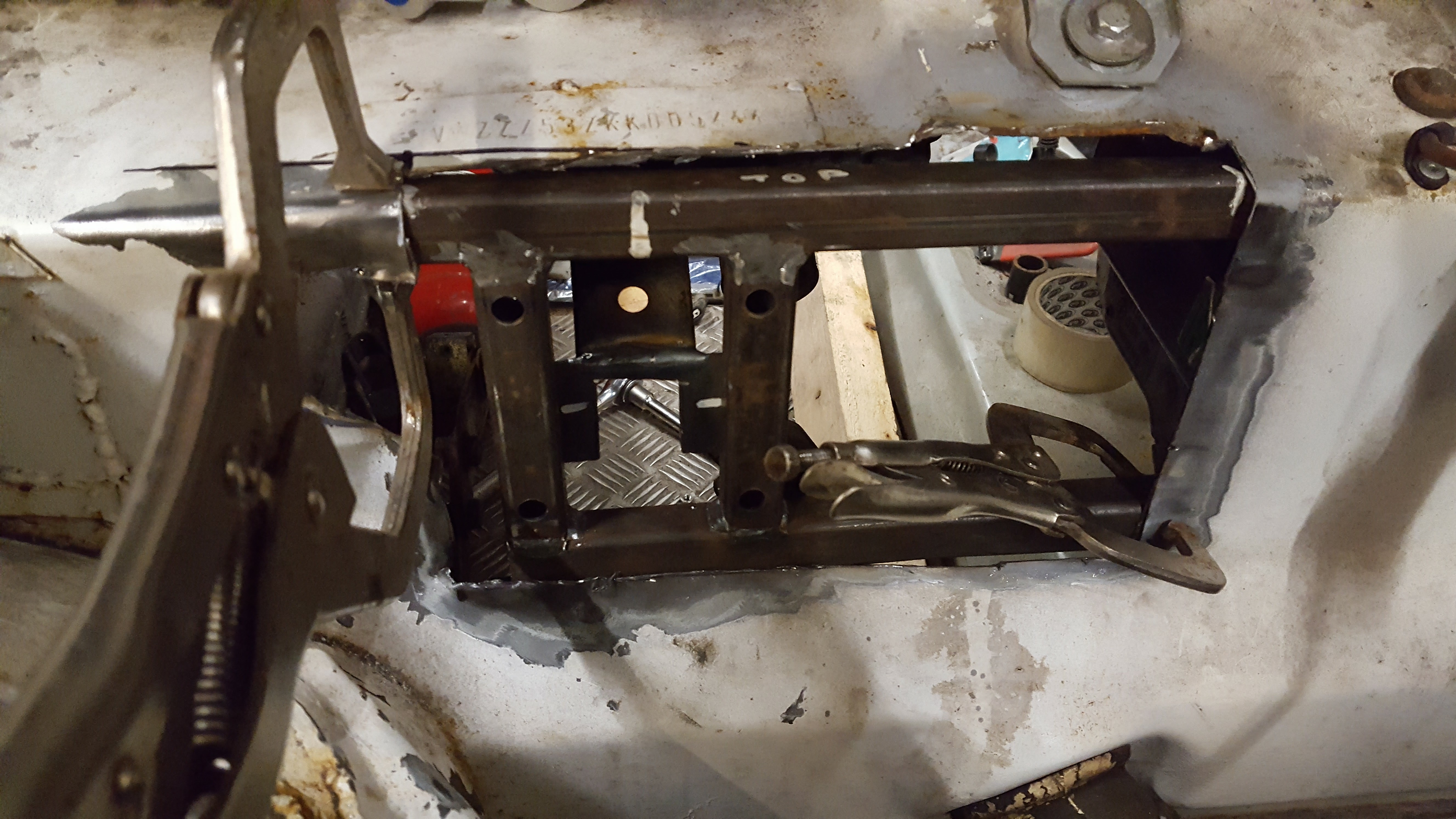

I made a frame for the pedal box to bolt to.

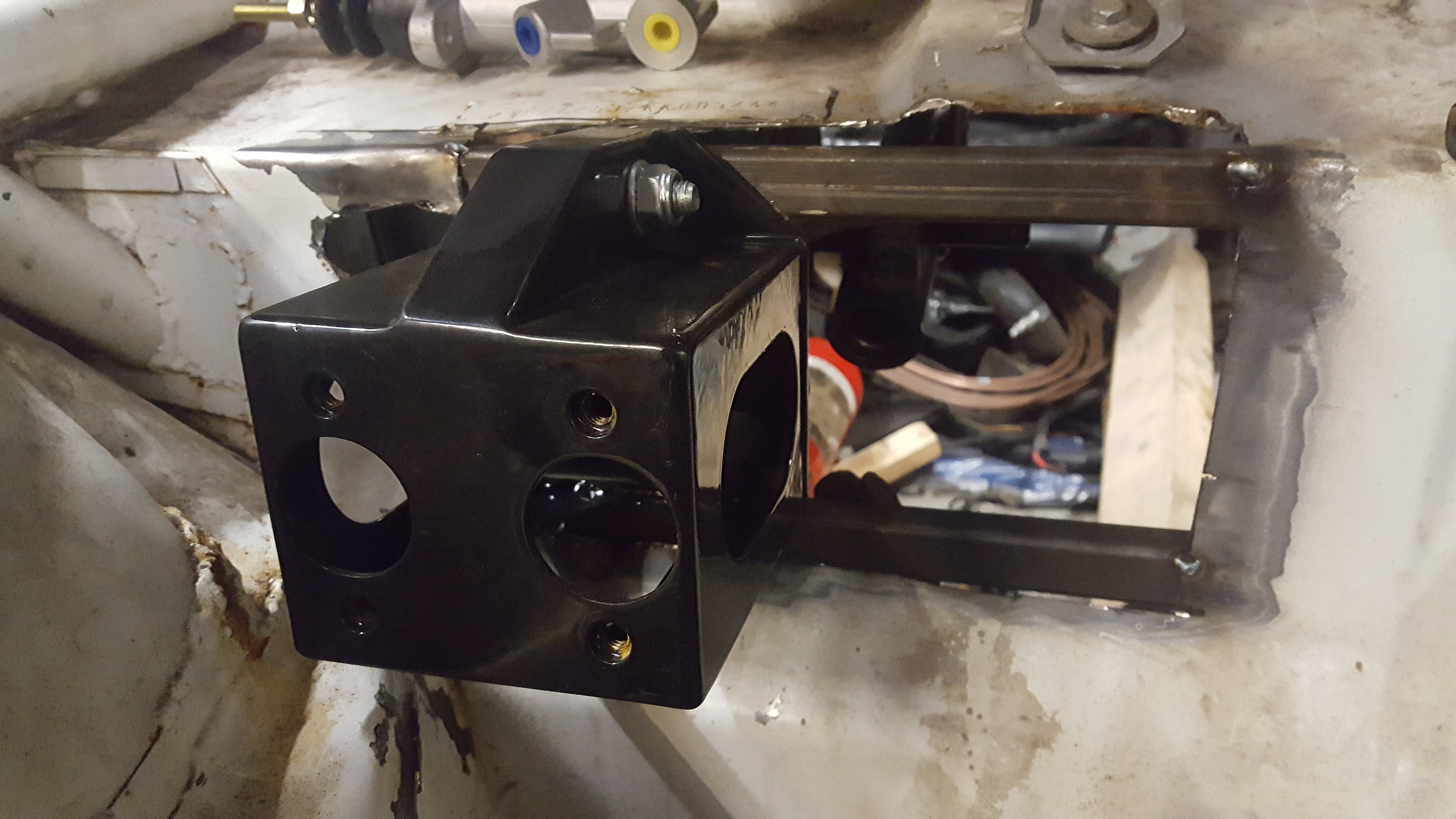

Then put a skin over,
All trial fitted and hydraulically tested so I just need to strip it down and make it more presentable.
