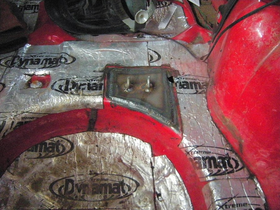

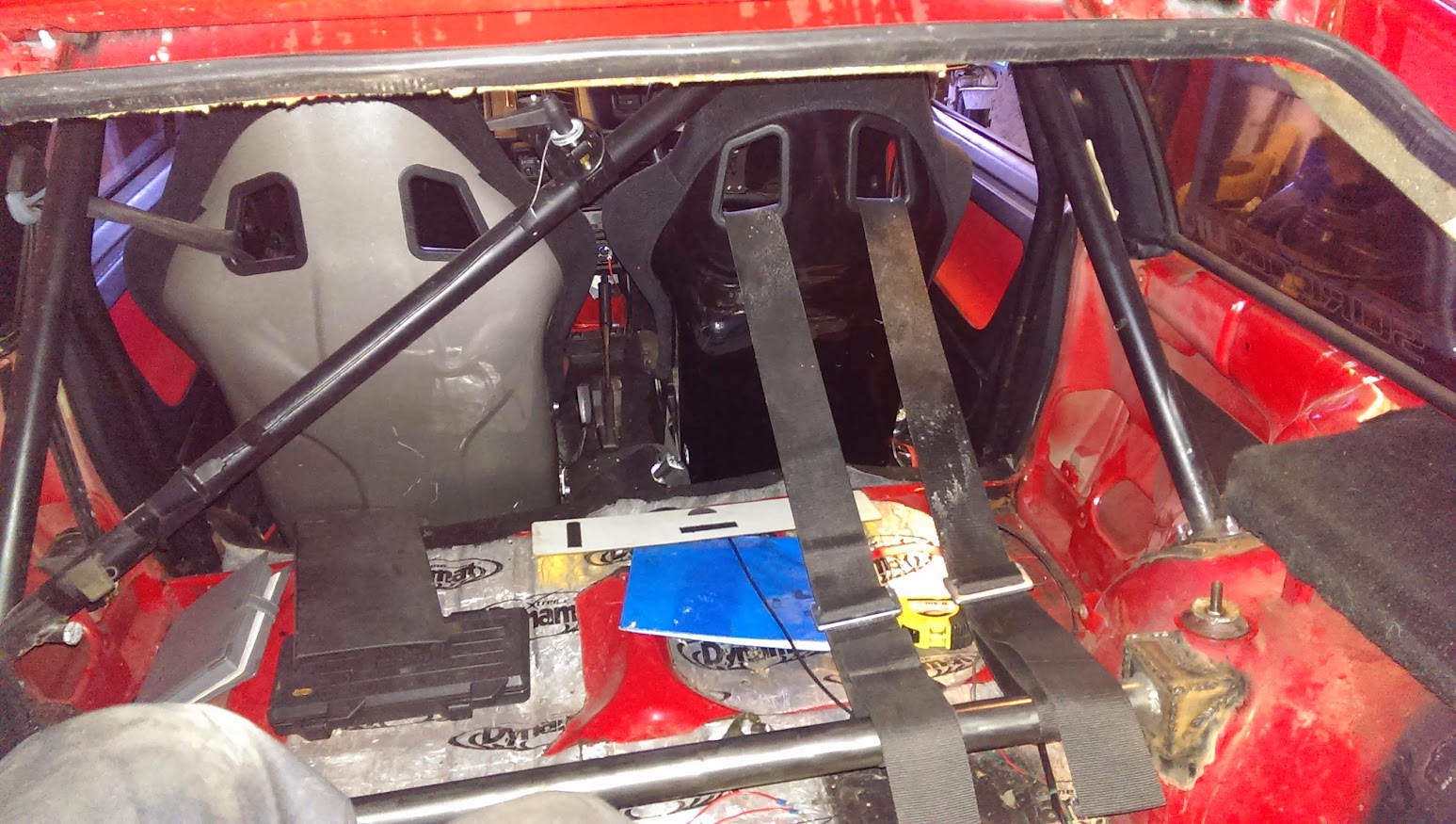

And I decided that I need a harness rather than the inertia belt. So I made a reinforcement plate for the rear straps.

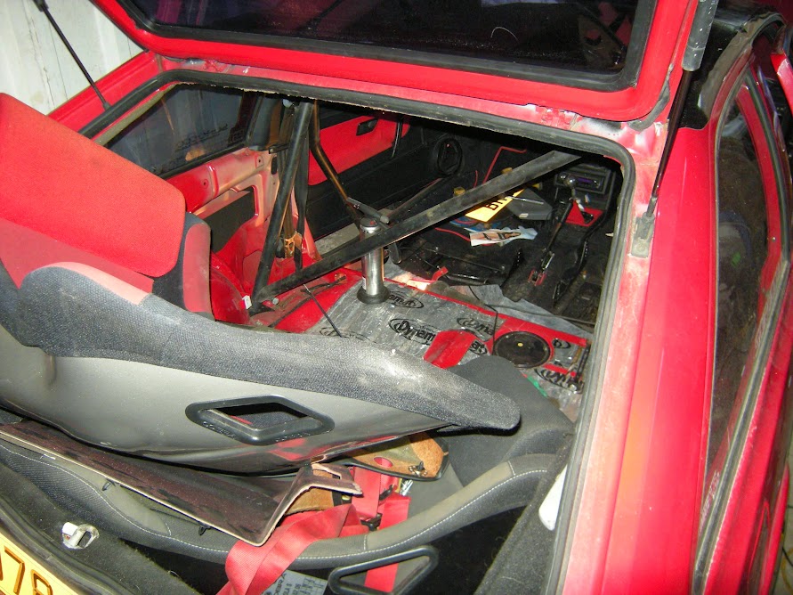

And then I remembered that I have a Safety Devices roll cage in the back of my garage. I could just fit the rear half to save me chopping up the dashboard.
Quite a bit of fabbing up of reinforcement plates and a bit of weld spatter burns later I decided it was time for pizza and beer.

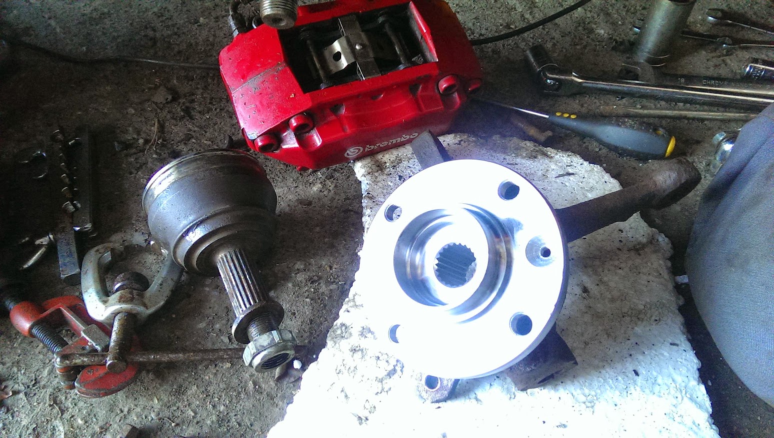

So, firstly the big Brembo 4 pots on new 305mm drilled and grooved discs. I was pleased to find that I have 2 sets of wheels that (just) go over these monsters. Gaz Gold coil overs and front top and bottom strut braces.
While I was checking things over I found a dodgy CV joint, a knackered wheel hub and split steering rack gator. New wheel hubs are available quite cheaply now :)

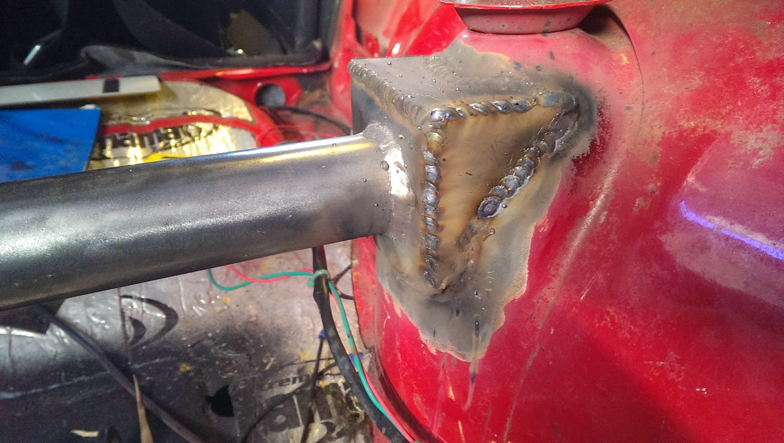

Post by Brunty » Fri Mar 06, 2015 11:19 am
After welding in the reinforcing plate for the harness I've gone and decided to fit a harness bar/rear strut brace. The materials are cheap enough so I've made it all myself...
And yes, I know the harness and car in general looks filthy! It actually looks worse in the pics, but it'll get a small clean this week :)
