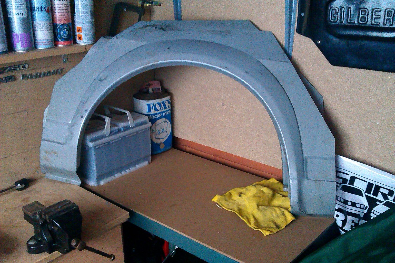

Oh I’ve also got some off these for welding in soon ;)
