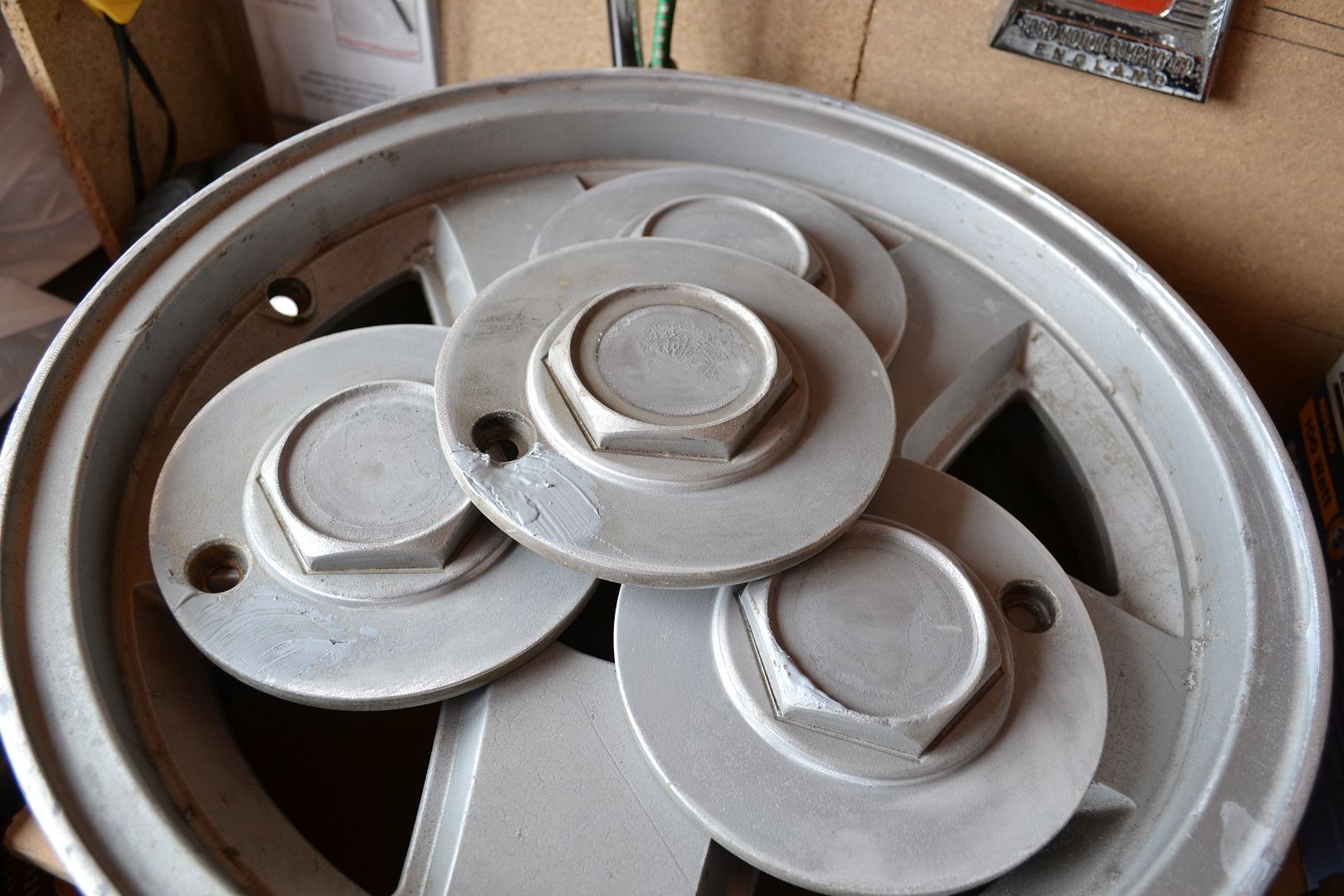

It did some in handy though for getting off the logos on the centre caps :)

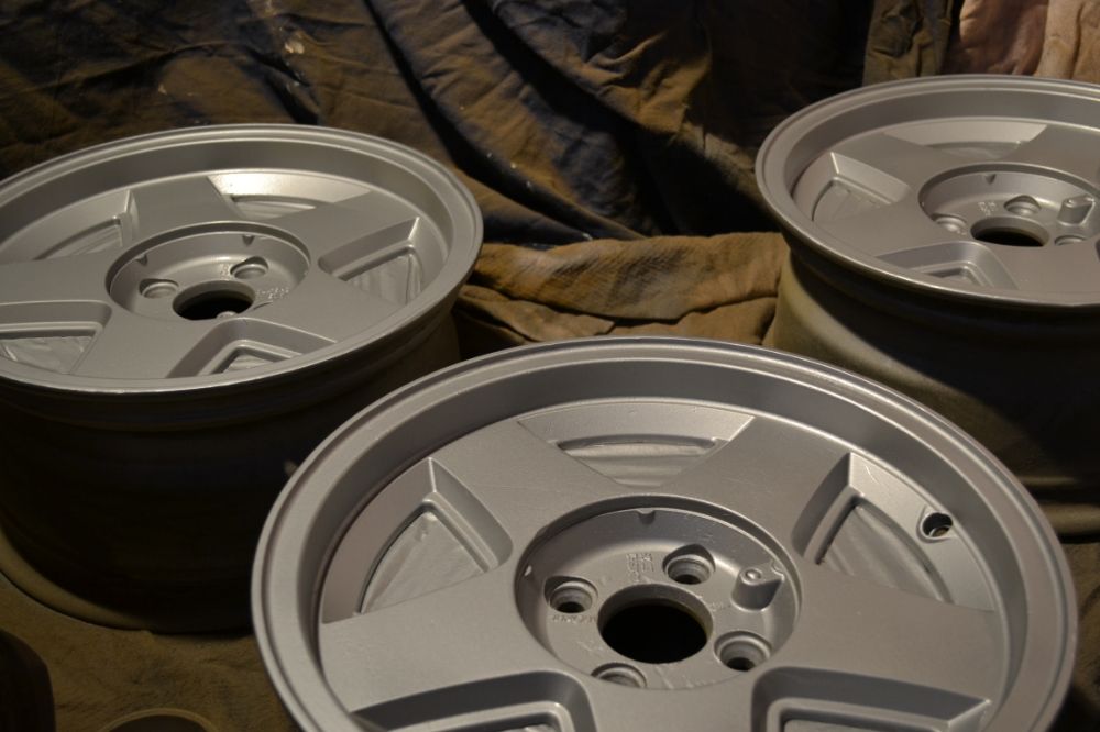

Well over the weekend I finished off the wheels, they got their final 2 coats of silver paint before getting 2-3 coats of Lacquer-
I even gave the bolts a quick covering as well ;)
And yesterday the final touches arrived (a bargain at £6)-
So their done, and I must admit I’m very pleased with the result :) . Is there anything I would do differently, possibly have sanded down the faces a little more, don’t get me wrong for less than £20 they look fantastic, but it didn’t realise how pitted they were until I started putting on the Silver, thankfully the lacquer helped out ;)

Those centre caps finish them off nicely. As I said before, can't wait to see them fitted. :thumbup:

Post by eefy » Tue Apr 09, 2013 8:40 pm
Me too Paul :) went for slightly larger logo which I think looks better than the originals
