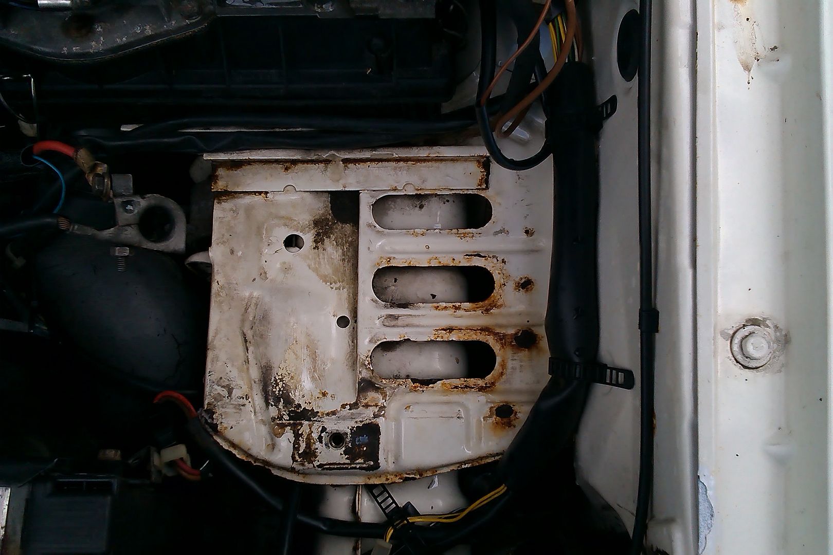

Over the last few weeks I’ve got a few niggly jobs sorted on the my rocco, the first was a degrease and clean of the engine bay (let’s just say it still needs more work), next was treating some rust on the battery tray-
Some white, as it turns out very white, Hammerite was liberally used in 2 coats for added protection.
