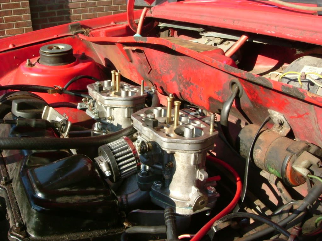

i am fitting larger larger idle jets to even out my tickover and the Saab electric brake pump to give me my brakes back.

this is where im at
Im running 60 idle jets and 130 main jets now and compared to what was in there she flies

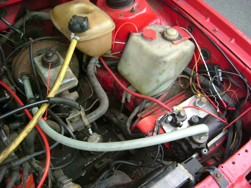

thats the saab vacuum pump fitted so i now have my brakes back pics to follow

and its a peirburg vac pump

Nice job, how do the brakes feel with that fitted? Same as before with the manifold connection?

Brunty wrote:Nice job, how do the brakes feel with that fitted? Same as before with the manifold connection?
they feel better its linked to the pedal switch so when the lights are on the pump is running.

Tonight i fitted 2 SCAT air filters and they look the puppies privates
pics will follow
