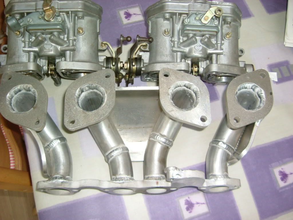

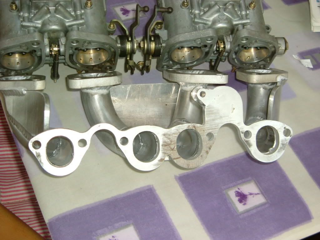

I now have the manifold for my IDF carbsImageImage now all ive got to do is get the thing fitted and working watch this space..................

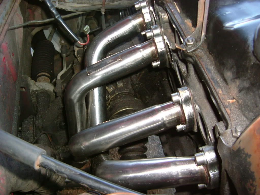

got a stainless 4/2/1 exhaust manifold fitted tonight because my intake manifold wouldnt fit with the standard ex manifold so hopefully i will be able to give it a run by the weekend
