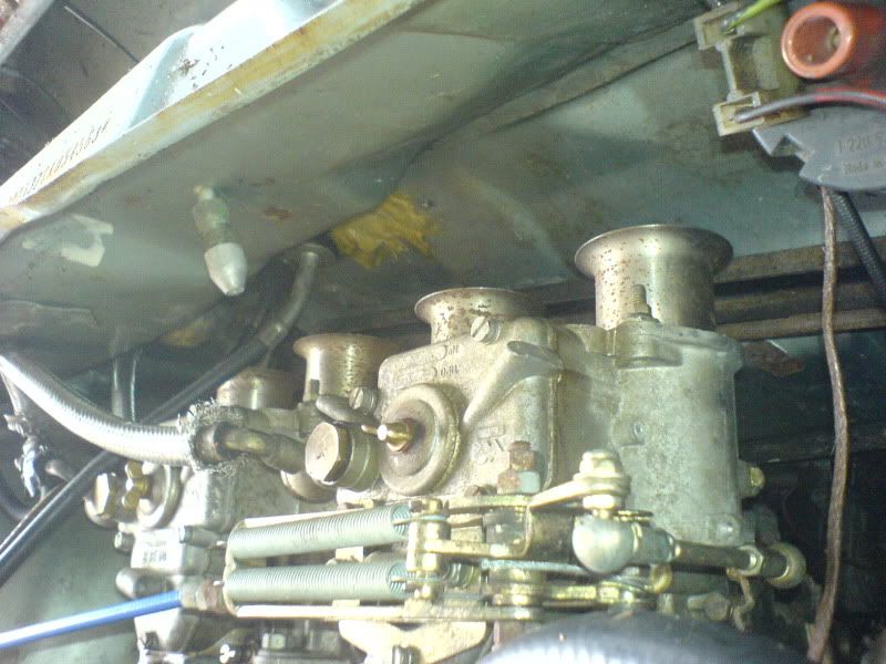

Post by Brunty » Sun Jun 05, 2016 12:49 pm
Weber 40s on the 8v engine look like this.
You can still get decent power, but they can be a bit of a squeeze. Still better than bike carbs though (I'm not a fan of bike carbs, they belong on small engines that have a lot of flow).
You can pick up cheap 4 branch manifolds now - have a look on ebay. The designs all look basically the same and are clearly based on Supersprint, but a fraction of the cost. I've used a couple and they seem absolutely fine.
On the 90bhp carb'd engine you can fit a fast road cam, 4 branch (4-2-1, rather than 4 in to 1), exhaust and the Weber dmtl carb and end up with approx 110bhp. With a ported & port matched head and Weber 40s you'll be looking at about 130bhp.
